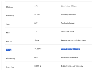

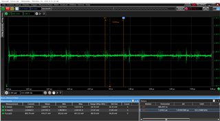

We got an issue that is power noise, currently we design TPS546A24A/TPS546B24A in our product.
Before we design them, we already simulated by using TI Webbench and the result is also good.
Also, TI FAE(Taiwan) did measurementt in the past, the report is pass. It measns that the design is OK basedon the result.
But, according to customer’s feedback, they found some cards worked abnormally recently, cannot connect to it.
They tried to measured signal and found Vpp is even up to 1V on the GPIO which is reset signal.
Due to the signal is reference to Vcc 12V power plane, they doubt it is related to power noise.
Please advise.
Thanks.

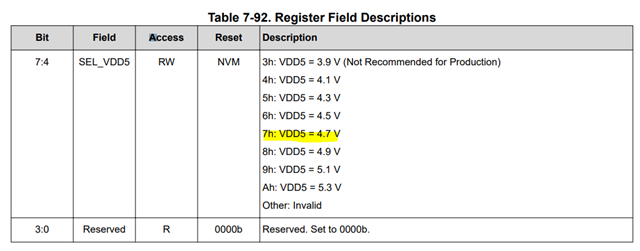

    However, it will cause PCB evolution. Currently, is there a possible way that we can set register value to solve it?
    Please advise.
    Thanks.
  • Hi Jack,
    Are you referring to the PMBus register value for a potential software fix? If so, one option you could try is adjusting the VDD5 setting in the (B5h) USER_DATA_05 (POWER_STAGE_CONFIG) Register. The default voltage is 4.7V. Lowering the VDD5 voltage level to 4.5V, 4.3V, or even 4.1V can decrease the gate driver strength and slow down the MOSFET switching transitions.
