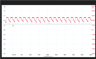

    Regarding the waveforms, I only have a 2-channel non-isolated USB oscilloscope... so, this is what you get in the waveform images attached:
    - Blue signal is always ERR;
    - Trigger is set for ERR (falling edge);
    - Red signal is VLED, ILED, 5V and 12V on the different images;
    - Duty-cycle is set for 50%;
    - ILED is very bad due to the fact that when I measure the current on the terminals of a 1R1 resistor in series with the LED with the oscilloscope, the LED turns off (probably due to the fact that this oscilloscope is not isolated).
    - Only one LED is turned on for this tests.
    For now, I still can't read FLAG_ERR and FLAG_STATUS but I'm working on it. But I can't see ERR signal going down...
    Any ideas with this information?

  • Hi Miguel,
    Could you measure the current via the current probe? if you don't have the current probe, an easy way to measure the current is that you can use a resistor to replace the LED load. For example, if your output current is 100mA, you can use the resistor of 30ohm or 60ohm (the power rating of resistors should be paid attention).
    Do you mean when you did the test, the VBAT and SUPPLY pins are set to 5V?
    From your code, the PWM frequency is set to2kHz, is it correct? but from the waveform, it seems like the device is running 400Hz PWM signal if the time unit is 5ms/div. please help check it.
    One small question, have you programmed the EEPROM value before? I am wondering if this device runs into the fail-safe mode otherwise the PWM setting or current setting won't be changed. If you could read the internal register value, that would be very helpful. thanks!
  • Hi!
    1 - I measured the current before. It is the image "20250225_BLUE-ERR+RED-ILED_DC50.png". I did explain on the last post: "ILED is very bad due to the fact that when I measure the current on the terminals of a 1R1 resistor in series with the LED with the oscilloscope, the LED turns off (probably due to the fact that this oscilloscope is not isolated)."
    2 - When I ran the test, VBAT and VSUPPLY are set to 5V.
    3 - When I captured this images, I was running the tests at 400Hz because I was trying different frequencies.
    4 - I did not program the EEPROM, at least intentionally. But, if it was in fail-safe mode, would it run the patterns that you have in your EVM code as examples? I am able to run the code in Patterns.c and I see all the 32 LEDs turning on and off and dimming up and down. Would it be possible if it is in fail-safe mode?
    Thanks!
