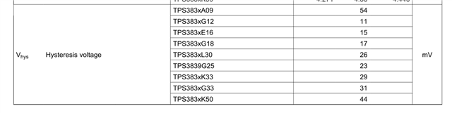

我找不到TPS3839G18DBZR的Vhsy最大值和最小值,您能分享資料或曲線給我嗎,謝謝。
For this device, the Vhys value is just the typ value and any variation is going to be based on the Vit- accuracy.
Jesse
SO when I design the turn-on thershold voltage, I only need to consider Vit-(max)+Vhys(typ),right?
