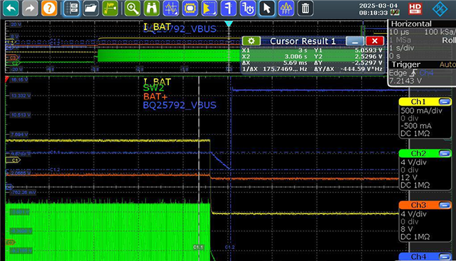

  • Hi Jeff,
    We found that the VBUS voltage would down to 2.5V when we did the VAC switchover. (From VAC2(5V) to VAC1(12V)) Is it normal? It looks like that it needs around 5ms to do switch over and the Vbus cap can't regulate the VBUS voltage.
    Does it mean that the VBUS cap is insufficient at this moment? Do you have any workaround?
    Roy
  • Hi Roy,
    VBUS=2.5V is below VBUS_UVLO.  I don't understand what you mean by "Vbus cap can't regulate the VBUS voltage".  There must be a delay on switchover in order to prevent connecting VAC1 source to VAC2 source.
    Jeff

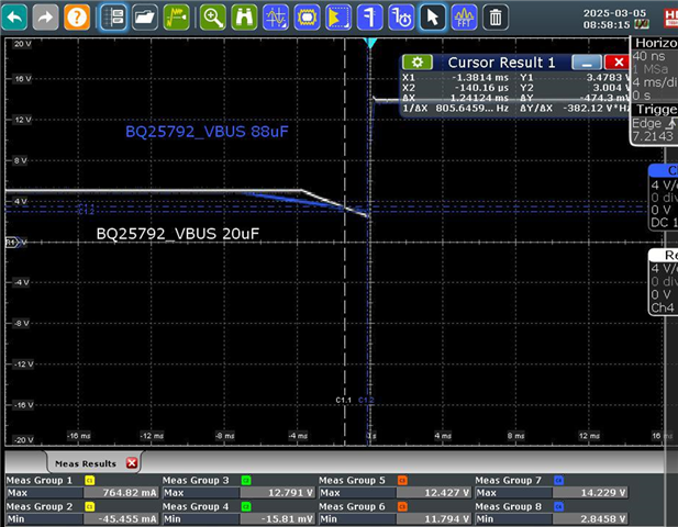

  • Hi Jeff,
    I mean if customer did the VAC switchover, the phenomenon(VBUS drop) is expected?
    I mean for VBUS drop, should we add more cap on VBUS to regulate the voltage when doing the switchover?
    I do believe this is not a normal phenomenon, otherwise we would recommend customer place enough cap on VBUS to prevent VBUS drop doing switchover.
    May you help use EVM board and measure the VBUS node when doing switchover? (5V-VAC2 to 12V-VAC1) We tried to add more cap on VBUS and it looks like that the switchover time wasn't fixed and VBUS would down to VBUS_UVLO and then switch the VAC.
    Roy
  • Hi Roy,
    VBUS drooping is not unexpected because the converter is still running when EN_ACDRx is set to 0 and before EN_ACDRy is set to 1.  If you don't want VBUS to collapse to UVLO, you can first set EN_HIZ=1 then EN_ACDRx=1 then EN_ACDRy=1 and then EN_HIZ=0.  That would prevent the converter from drawing current from the VBUS capacitors during the switchover.  So, in theory, with a big enough capacitance on VBUS, VBUS voltage would not drop below VBUS_UVLO.
    I do not understand what the concern is here.  No other customer has asked about this.  What is the issue with VBUS dropping below VBUS_UVLO?  If a battery with voltage > VBAT_UVLO is present, the registers do not reset.
    Jeff
