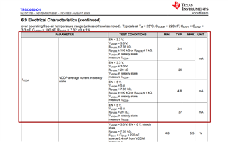

I am currently working with the TPSI3050QDWZRQ1 and reviewing its datasheet. However, I could not find any information regarding the leakage current of the EN (Enable) pin when it is left floating or pulled to a logic level.
Could you please provide the typical and maximum leakage current specifications for the EN pin in of TPSI3050QDWZRQ1 operating in 2-wire & 3-wire mode over full operating temperature range i.e. -40 degC to +125 degC ?

    There is a 1MOhm Pulldown resistor from the EN pin to VSSP that results in a leakage current proportional to the EN pin voltage (Ven/1MOhmwhen it is left floating or pulled to a logic level.
    In Two-wire mode, the Enable pin currents at startup and steady state for minimum (RPXFR = 7.32 kOhm) and maximum (RPXFR = 20 kOhm) power transfer settings are expressed in this section of the data sheet:
    In Three-wire mode, power is supplied through VDDP and is transferred to the secondary side when the EN is toggled, the datasheet specifies the expected current on VDDP here:
    Please note that in Two-wire mode, power is supplied via the EN pin which then charges the external capacitance attached to VDDP (determines EN pin current) before transferring power to the secondary side (as mentioned in the data sheet):

    Thanks for clarifying. We expect the leakage current of EN pin in 3-wire mode to be lower than values mentioned above for 2-wire mode across the operating temperature of the device.
    I have looped in relevant team members on my end to get an answer and will be in touch once we come to a conclusion.
    Until then, please note the following expectations for the leakage current in 3-wire mode across temperature range:
    Device Disabled:
    IEN, Max = Ven/1MOhm → {Ven < VIL_EN}
    Device Enabled:
     IEN, Max  pending investigation
