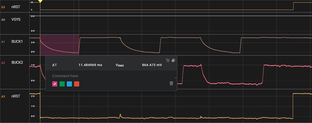

  • Hi Sandeep,
      The total time depends on the device configurations since reset runs the power-down sequence first and then runs power-on sequence.
      I just measured the average time between power down completed and start to power on again which should be independent from configurations; the average time is about 10.5mS as showing by screenshot below:
    Thanks!
    Phil
  • Hello Phil,
    Thanks for support
    Can we consider the average time for all the list of faults in P2 category will have same time 10.5mS ?
    What about when multiple faults are occurred at once (2 or 3 or more) ?
    What will happens if the faults has not cleared even after multiple RESETS by PMIC ?
    Sandeep P
  • Hi Sandeep,
       Yes; the 10.5mS is the interval time between reset cycle. When multiple faults are occurred at once; the interval time should be counted from the last one.
       The reset cycles don't stop if the faults has not cleared even after multiple RESETS by PMIC.
    Thanks!
    Phil
