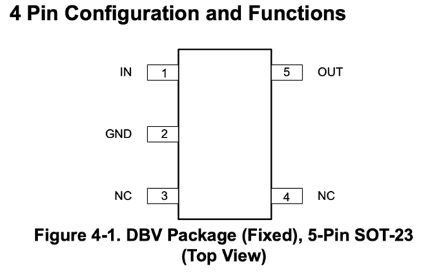

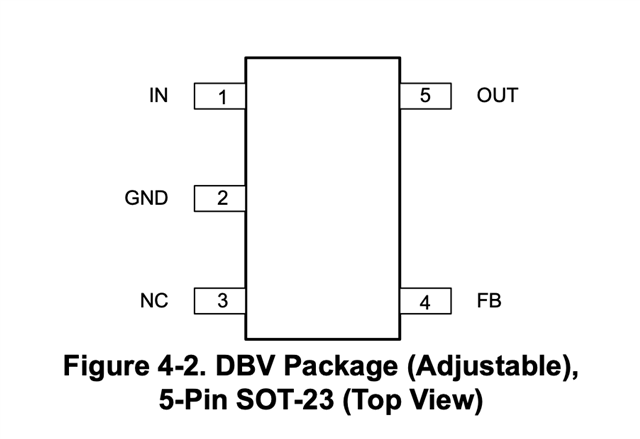

I think you have a mistake in the datasheet. You write on page 3 that the input is pin 1, fb is pin 4 (if adjustable) and output is pin 5.

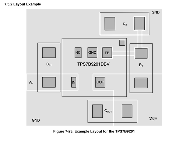

But in your example pcb on page 28, you have fb as pin 1, input as pin 4 and the measurements are crooked.
I'll take it that the information on page 3 is correct and page 28 needs a revisit?
