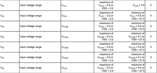

  • Hello Stanley and Leo,
    I think there is still some confusion. BQ76905 should still work. VC5 needs 2V common mode. This means, even if the differential of VC5-VC4A is <2V, as long as VC4A to VSS is >2V it should be fine. The resolution may not be as good.
    If the voltage range of the 4S cylindrical primary lithium is 3.2V, a minimum of each cell should see 3.2/4=0.8V, 3 cells below top cell at minimum cell voltage --> 3*0.8 = 2.4V --> 2.4 > 2V common node.
    As shown in the datasheet, the minimum cell input voltage is the MAX (VCx-0.2 OR VSS-0.2).
    Alexis

  • Hello Stanley,
    Information on the resolution can be found in Section 6.12 Analog-to-Digital Converter from the datasheet. It won't say the resolution may not be as good when VC5-VC4A is <2V. It is a possibility as the batteries being used are only using a small portion of the entire ADC range our device can provide for.
    Alexis
