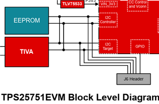

    Does the I2Ct and I2Cc needs to be shorted for PD controller(TPS25751S) to boot from EEPROM or PD can read it from EEPROM from I2Cc port?
    Additionally, does the VSYS pin have any dependencies for the PD controller's boot process? We have this concern because the VBUS(pin - 26,27) and VSYS(pin - 19) pins are shorted in our design. Could this prevent the PD from booting?
    Monisha M
  • Hi Monisha,
    You should never short the I2Cc and I2Ct ports when they are being used. The EEPROM should be connected to the I2Cc ports. The I2Ct port is a target/slave I2C port.
    See the TPS25751EVM for an example of the connection. You can see the configuration EEPROM connected to the I2Cc lines.
    Why do you have these shorted, it is not expected for these pins to be connected? I'm not too sure as this is not expected behavior. This should definitely be fixed, but I would recommend addressing the I2C connections first to see what happens.

  • Hi Chris,
    We haven't shorted the I2Cc and I2Ct ports. From the TPS25751EVM block diagram, it is found that I2Cc and I2Ct ports are shorted. Therefore raised this query for clarification.
    And regarding the VBUS and VSYS , it was accidently shorted. We will try to fix this issue.
    Monisha M
  • Hi Monisha,
    Thanks for pointing that out. I quickly reviewed the schematic and confirmed that the I2C lines are not tied together on the EVM, it seems to be a typo in the EVM user guide.
