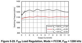

Datasheet Fig.5-25 shows that Fsw is lower than set value in case of FCCM.
Under the following condition, the Fsw diviation from setting value is within expected range?
[Condition]
Vin:12V
Vout: 5.1V
Fsw(setting): 800kHz
Fsw(measured): 675kHz
Also, how did you measure the Fsw (setup) for the datasheet plot.

  • Hi Goto-san,
    That figure should be based on actual data. At higher VOUTs there can be a dip in frequency from the setpoint so these numbers look fine. However, you need to check is if the design is as per datasheet guidelines and if the SW waveform looks stable and also the overall design itself should be stable - can check this with a load transient for example.

  • Hi Goto-san,
    Yeah these are secondary effects that are probably not modeled in the tools. My recommendation would be to use an EVM to measure the use case and make sure it works for your requirements.
