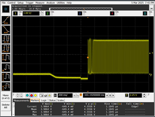

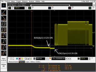

  • Hello Harry,
    I measured between the HB(+) and SW(-) terminals with a differential probe.
    I have attached the waveform.
    The waveform between the terminals has a negative potential before oscillation begins.
    Is this normal behavior? What causes this behavior?
    The measured output voltage of the IC is normal.
    The timing when 12V was applied to the BIAS pin
    and the timing when 3.3V was applied to the EN pin have been added to the waveform.
    Best regards
    Katsuki.

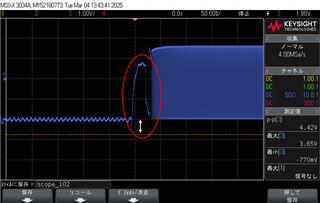

  • Hello Harry,
    Is the behavior of the waveform circled in red in the attached waveform normal?
    Also, what could be the cause of this?
    Please let me know the possible causes.
    Best regards
    Katsuki.
  • Hello Katsuki,
    Did I understand correctly that the yellow signal is the voltage across the HB capacitor (from HB to SW)?
    It should not be switching so much.
    Maybe you can show me a zoomed in version which just shows a few cycles.
    Maybe you need to use a different capacitor on the HB pin.
    It needs to act as an cycle-by-cycle energy storage for the high-side gate-driver.
    This capacitor needs to be low ESR, low ESL, and have a very low leakage. Also, considering the DC BIAS effect, please choose a capacitor with a high nominal voltage.
    Why are there two different voltage levels in the upper image (with these two short drops)?
    What is going on there?
    What is the blue signal?
    Is it also the HB vs. SW voltage?
    Can you please show the VCC vs. GND voltage in parallel / in one screenshot?
    Harry
  • Hello Harry,
    We would like to know the reason for this.
    Is there anything you can predict?
    The timing of the two drops occurs when the BIAS power supply
    is turned on and when voltage is applied to the EN terminal,
    as shown in the first waveform.
    Let's try adjusting the capacitance of the capacitor on the HB pin.
    The blue signal shows the waveform between the HB(+) terminal and the SW(-) terminal.
    I will also capture and send the waveform between VCC (pin 9) and GND.
    Best regards
    Katsuki.

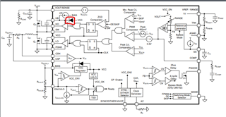

  • Hello Harry,
    There is a diode in the path supplying VCC to the high-side gate driver.
    What is the leakage current that flows in the reverse direction through this diode?
    Best regards
    Katsuki.
  • Hello Katsuki,
    I am really confused by your description about the two drops. The BIAS and EN events are happening much earlier ...
    Anyway, that diode from VCC to HB is integrated into our device.
    Do not use an external diode in addition!
    An external diode would cause issues.
    If I misunderstood, what else do you mean with "There is a diode in the path supplying VCC to the high-side gate driver."?

  • Hello Harry,
    Sorry, I forgot to attach the image.
    This is the diode inside the IC shown in the image.
    Best regards
    Katsuki.

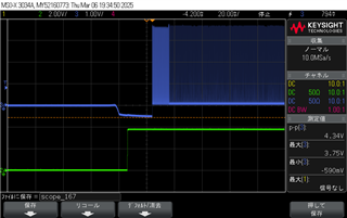

  • Hello Harry,
    I checked the voltage at startup on your evaluation board (LM5123EVM-BST).
    The waveform was acquired with a differential probe.
    The blue line is the voltage between the HB (+) and SW (-) terminals.
    The green line is the voltage between VCC (+) and GND (-).
    Just like the waveform measured on our board, a potential of -0.59V is displayed
    Does this mean the device is operating normally?
    Also, what causes this?
    Please let me know.
    Best regards
    Katsuki.
  • Hello Katsuki,
    The negative voltage on the HB pin BEFORE the first switching of the FETs is normal.
    The HB capacitor will only be charged (with a positive voltage) when the low-side FET is turns on for the first time.
    Elder devices often required an external diode and customers ran into issues because some wrong diode was chosen.
    So, we decided to integrate it into the controller to make sure that it will switch fast enough and has very low leakage.
    The voltages (VCC and HB) in your screenshot are vey low. Basically too low for a proper operation.
    VCC should usually be regulated (down) to 5V.
    When the BIAS voltage is bigger than 3.8V, the controller will start working.
    But it can not generate 5V on the VCC pin and the HB voltage will be even lower (3.75V in your measurement).
    So I would believe that in your setup the BIAS voltage is just around 4.2V.
    With such low voltages it is not guaranteed that the FETs are switching properly.
    Also, the timing of the FETs can be different than expected and you may encounter false turn on / turn off events going on.
    Worst case this may even lead to cross-conduction between the two FETs.
    Therefore, please increase the BIAS voltage in your system.
    Either make sure that the input voltage will not fall below 5.5V
    Or connect the BIAS pin to VOUT instead of VIN.
    For startup, VIN will go across the body diode of the high-side FET to VOUT and also to BIAS, so it has to be around 4.5V .. 5V to allow for the controller to start up.
    But when the input voltage drops afterwards, the controller will be supplied by the self-boosted output voltage.
    This discussion just reminds me of another problem which can occur with a lab setup and which might cause your original issue:
    If the lab supply for VIN is running into a current limit it may happen that the boost converter cannot deliver the required energy to the output.
    It will also not go into any protective mode as there will never be an overcurrent happening.
    This constellation can also damage a converter stage.
    So, please make sure that the lab supply will always deliver the required peak inductor current plus same margin.
    Best regards
