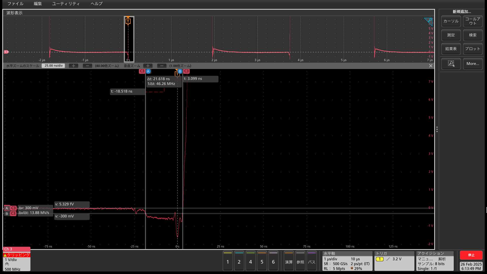

The figure below shows the waveform at the SW terminal.
The time it falls below -0.3V is more than 20ns, so it does not meet the absolute maximum rating.
I think this is because it was evaluated using an individual with a deadtime of around 22ns, but can we assume that there is no problem if it exceeds 20ns slightly?

    Of cource, the measurements are used with tip and barrel method.
    I confirmed that the SW terminal voltage adheres to the absolute maximum rating.
    The measurement conditions are
    ・Using LM5148 to design a 48V input, 24V output circuit with dual-phase, PFM setting.
    ・the attached file shows the waveform when the output current is 1A and 10A.
    While the inductor current flows through the body diode of the low-side FET, the SW terminal voltage exceeds -0.3V,
    and the time that it exceeds -0.3V is at least tdead2 (LO off to HO on deadtime),
    and in discontinuous current mode at light loads, the time period is longer than this.

    I took the scope shots.  You can see its not as bad as the images you sent me.  This was taking on the SW falling, which is the worst case, rising edge shows very benign waveforms not even close to violating the -0.3V spec.  Please also note: the -0.3V is a DC specification not a switching one, so even the waveforms you took are OK.
    Here is what I took, you can see the DTs is less than 20ns.  and it quickly goes above the -0.3V specification.  Again, I think these waveforms are acceptable.

    I don't understand why this waveform is OK, so please explain.
    【Question1】
    Is the 19ns period of your measured waveform tdead1 (HO off to LO on deadtime)?
    【Question2】
    The 20ns for tdead1 and tdead2 is a typical spec, and there should be some units that exceed 20ns.
    That unit cannot apply transient<20ns and cannot comply with the absolute maximum rating. How should I think about this?
    【Question3】
    The period when it exceeds -0.3V is 122ns. If it is within 20ns it will be relaxed to -5V, but that cannot be applied.
    I don't understand why this is OK, so please tell me the details.
