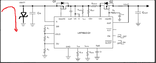

    Actually, we dont use a TVS for positive side clamping. It is present just to block the power path. Otherwise, power source is just shorted to ground via TVS-.
    Actual clamping is required only at negative side as the transients in automotive violate the abs-min rating.

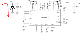

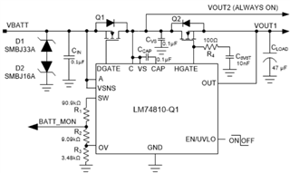

    On the other hand, from the datasheet that you referred, at least I understand now why we need two unidirectional TVS back-2-back (instead of one bidirecational) for a MOSFET w. VDS=40V. The reason is, that these unidirectional TVS diodes are not identical, they are different (having different characteristics) as shown in the figure below:
    However, what I still do not understand that why SMBJ33A is chosen for the positive side with breakdown voltage of 36.7V min, 38.6V typ. @25*C which could increase to 42.46V @125*C?
    Could you elaborate on that?
  • Hi Ferenc,
    Other than load dump pulse 5A, all the pulses are low on energy, and we rely on input and output capacitors to suppress them. Due to which controller remains safe. Pulse 5A is high in energy and TVS may not be able to clamp it (unless very strong TVS used). Hence, we use a special common source topology shown in datasheet to tackle that which uses OV pin of the controller to protect downstream load.
    SMBJ33A is chosen on positive side because a suppressed load dump pulse is of 35V in a 12V automotive system and TVS will not breakdown and try to clamp it. Controller is rated for 65V so it should be okay. If downstream load needs to be protected, we can use the OV pin.

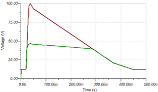

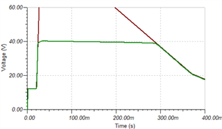

    Although I have never used TINA TI, now I made a rapid learning to put up a simple simulation with load dump pulse generator using piecewise linear curve and two TVS3300 / TVS1800 device back2back, as was shown in the above diagram. Based on ISO7637-2 the internal resistance of the load dump pulse test generator is between 0.5 and 5 Ohm. Then even if I set the max. value of 5 Ohm, the voltage is slightly above 40V (max. spike around 40.1V).
    However, if I am setting the internal resistor of the generator to 0.5 Ohm, the voltage goes up to 46-47V.
    It seems to me that if you want to comply with ISO7637-2 then there is no way to use MOSFET w. 40V VSD. Am I right, or did I missed something?

    If you want to comply with ISO7637-2, 40V rated FET can be used, there isn't an issue. If there is a trouble with TVS+ selection, you can simply add a schottky rated for > 35V so that it doesnt get damaged during load dump. As I explained, the role of TVS+ is just to block the power path.

  • Hi Ferenc,
    ISO7367-2 has quiet a lot of pulses but we try to cater only pulse 1 which is -150V(peak) transient which is high in energy as well cannot be suppressed by input and output capacitors.
    To cater that pulse, we use TVS- which clamp on the negative side to keep the controller safe and also VDS of the FET safe. For a 12V system and 40V FET, we try to clamp under (40V-16V) = 24V. For this SMBJ18A or TVS1800 works fine. I hope we are clear for this.
    Next high energy pulse is the load dump pulse which is a 35V peak for >40ms which more of a DC situation and TVS cannot clamp it. Now, to work with this and protect downstream load, we use controller's OV pin and turn-off the HGATE.
    Now as I explained earlier, the TVS+ was present just to block the power path.
    The diode/TVS+ should be rated enough to withstand and not damage.
    Now, I am unsure why you assumed that schottky should be rated for <40V. Can you help me understand? Are we misunderstanding something?
    Also, if you don't agree with any part of my explanation, please feel free to correct me.
    Shiven Dhir

  • Hi Shiven,
    One last question regarding TVS- selection. In the page that you embedded as your first response, SMBJ16A is proposed for TVS-.
    However, when I am looking into the datasheets (see LittleFuse, STMicro, Microchip, or Nexperia), the max. clamping voltage for SMBJ16A is 26V >24V.
    Is that still OK?
    Ferenc
  • Hi Ferenc,
    Max clamping voltage maybe 26V. But during ISO pulse 1, it clamps under 24V as the current is lesser compared to rated current against max clamping voltage,
    Shiven Dhir
