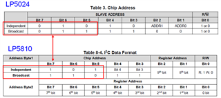

Dear Sir,
I am planning to use the LP5810 and LP5024 ICs in my design, both of which use the I²C protocol for communication. I have the following query:
Can both the LP5810 and LP5024 be controlled using a single I²C bus, or will there be any address conflicts? If there is a conflict, what would be the recommended approach to resolve it?
I would appreciate your guidance on this.
