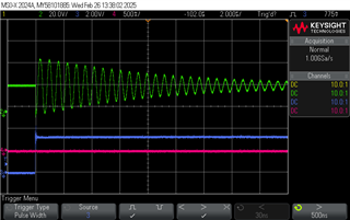

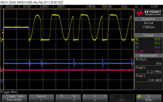

we are facing an issue with TPS922052 during start-up. The inductor current needs several pulses on PWM pin to settle at the set 1A.
To avoid soft start a 6us pulse is sent to the PWM pin during start-up. To avoid sleep mode a 200ns pulse is sent every 50ms.
This setting was working in an older prototype but with a new one (layout changes only, same schematics) we are seeing the issue. It looks like the driver is running in any limit because the SW pin is immediately release when pulled down.
Yellow: Switch node during first PWM pulse.

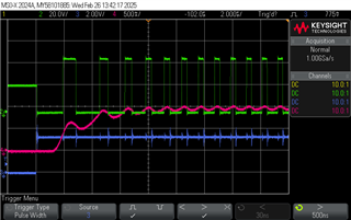

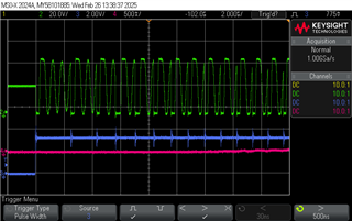

  • I have captures more images. The PWM signal is high for 100us. Duty-cycle not defined as I am controlling manually.
    Input 48V
    Output 10x white LEDs ~30V
    Current: 1A
    Blue: PWM Input:
    Red: LED current
    Green: Switch node
    1. Trigger - LED driver does not start switching.
    5. Trigger - Seeing a transition but no proper rectangle signal
    20. Trigger - Current rises to 1A
  • Hi Philipp,
    If this only happens during the first several EN/PWM pulses after the device have been enabled, then I would say this behavior is expected since the COMP voltage have not yet been built up and the device needs some time to charge up the COMP voltage and enters into CCM from DCM.
    Could you have a double check with the older prototype? Is the only change the layout? Is there any other change like schematic components, input/output conditions, etc.?
