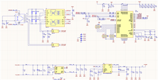

Schematic Review required for TPS2378 and its required transformer and PoE circuitry. The TVS part number is SLVU2.8-4BTG.

Hi Basit,
Please see the comments about TPS2378 circuit only:
1. Please add Bob-Smith termination circuits at both pair 12-36, and pair 45-78. And the Bob-Smith termination ground should be isolated with other grounds.

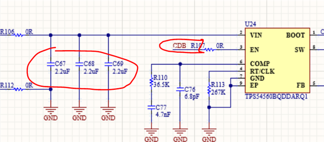

2. The bulk cap of Class-4 normally needs > 22uF.
3. CDB is open drain pin. Please make sure U24 has EN internally pull up.
