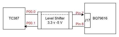

we interfaced EVM with TC3X7 TFT development board through J17. Since we are using single module, we made it as a base device bx populating J2, J18, and J21 and not J1.
we used level shifter to shift 3.3v to 5V

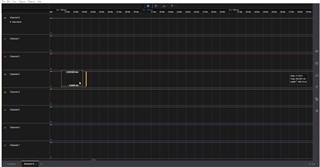

In the AUTOSAR CDD, we pulled the pin P00.0 to low for 2.5ms and then pulled it high but still board is not waking up (D1 LED is not glowing).
UART Configurations:
Baud rate = 1Mbps; data length = 8bit; Stop bit = 1bit
