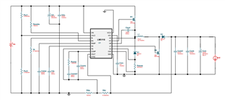

I have used TI Webench Power designer for design help of generating 9V @1A using a 3.7V battery and LM5118MH/NOPB Regulator. When we tested the PCB, The IC (LM5118MH/NOPB) is getting 3.7V VIN, enable pin is getting 3.7V but output of 9V is not being generated. We have tried removing IC and re soldering the same LM5118MH/NOPB. At last Output is coming "0". This is an urgent requirement. This is the schematic used

  • Hello stefan,
    There was a small mistake in my PCB. I have corrected that mistake and tested the board now. Initially I started raising the voltage from 3.7V by 0.1V, when the supply voltage reached 4.4V the output of 9V is achieved without any Load. I didn't even provide 5V to start Controller.
    Now, my design requirement is generating 9V@1A for 3-4.2V Input range.
    It is contradicting both webench design and datasheet. Please give your insights on this.

  • Hello Stefan,
    Thanks for the reply.
    In that case, the device shall work once it is operated in 4.4 - 5V for few seconds and then switch back to 3.7V.
    When I started supplying from DC regulated power supply, I have provided 5V input and then after 10-15 seconds I started reducing towards 3.7V. The Output Voltage gradually getting dropped when I am decreasing from 4.4 to 3.7V.
    This shouldn't happen right ?
    Ejaz.

  • Hi stefan,
    The Mosfet used is same for both M1&M2 which is CSD13202Q2. The Miller Plateau of this Mosfet is 1.5V approximately.
    Ejaz
  • Hi Ejaz,
    good this the MSOFET should be working fine under this condition.
    Can you please provide some scope plots of: (showing each a few ms and a few switching cycles (5-10)
    - HS / HO / LO / HB
    - VIN / VOUT
    - COMP / SS / VCC
    You can also try to supply VCCX with an external supply e.g. 5V and check if this changes the behavior. This would give some more indication for the root cause.
