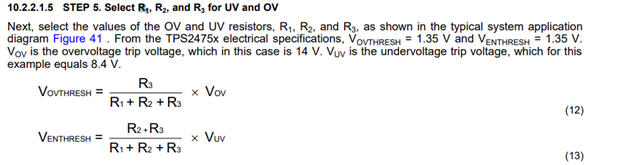

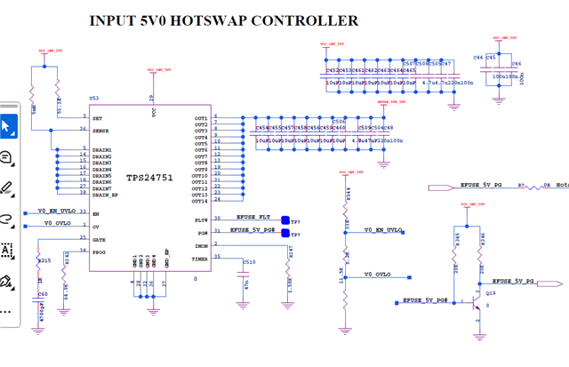

we are using the TPS24751 for E fuse monitoring
Our thershold limits are given Below
OV:5.25V
UV:4.75V
Current limit:6.6A
I have calculated by using the formula present in data sheet I am getting the OV exact value but lower threshold i was not able to get
Condidered resistor values
1.R1-33k
2.R2-10k
3.r3-15k
can you please correct me if I have done wrong and also how to calculate the current sense value
