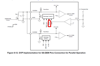

We are currently debugging our 5171 circuit.
I have a few questions about this.
what is the meaning of IC SD ?
p. 20 LM5171 Datasheet (SNVSCM3)
I would like to know what could lead to trigger discharge control?
Is the upper "discharge control I (1)" an the lower "discharge control II (2)" or is it the same discharge control?
Thank you very much for your help.
Greetings
  • Hi Viktor,
    "IC SD" means IC shutdown.
    This is the discharge logic of the soft start capacitor.  SS/DEM1 and SS/DEM2 are independent.
    EN1, DIR FLIP, IC SD, OVP will discharge SS/DEM1
    EN2, DIR FLIP, IC SD, will discharge SS/DEM2
