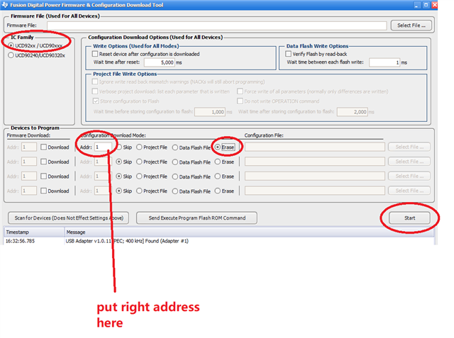

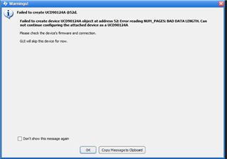

UCD90124: Unable to connect to tool
Part Number: UCD90124
I accidentally unplugged the cable while connecting the UCD90124ARGC to the TI-Fusion-Digital-Power-Designer.
After that, when I connected it to the tool, it still displayed "NOT Device."
Has the boot area been corrupted? I
s there a way to restore it?
Please support me.
