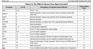

Hi All,
I have a question about the EN pin of the TPSM63610.
A customer accidentally designed the EN pin to be open.
However, the TPSM63610 worked normally. Why is this?
However, there seem to be individual differences in the TPSM63610, with some devices working normally and others not.
Is the EN pin weakly pulled up internally by something?
