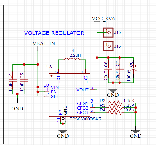

TPS63900: Please review the Schematics of TPS63900
Part Number: TPS63900
Hi Team, Please Review my Schematics
for Vout=3.6V
    Could you adjust R2 to 1.15K? which is recommended in table 7-2 in DS.  Since Vout set is always 3.6V no matter Vsel is high or low. why do not you just connect SEL pin to Vin?
    Tao
    Thank you for the reply
    I have shared the Updated schematic, please review this
    And we are using a 3.6V 17Ah Li-SOCL2 Battery (SAFT / TADIRAN) as a input
    and we are using this for the Nb-IoT application for water meter.
    can you suggest that is it worth using this regulator (TPS63900) for my application
    Another kind remind that output cap should be close to device, then the jumper connected to your load in your actual layout.
    TPS63900 should be an excellent device for your application, because it is ultra low quiescent current and high efficiency in light load. But be carefully check if  the maximum output capability can meet your NB-IOT module or not.
