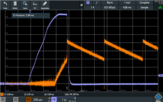

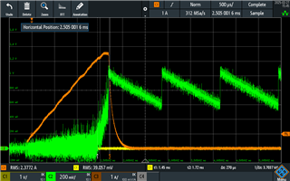

TPS7H5005-SEP: HICCUP capacitor was NOT discharged to 0.3V properly.
Part Number: TPS7H5005-SEP
Dear team,
I have attached the HICC PIN vs our output load current waveform , In that HICC pin was not discharged to 0.3V as mentioned in the datasheet. Once it reaches the 0.6V it again pulled to 1V like that it continuously operating between these thresholds (1V to 0.6V ). NO OUTA was observed after that. Soft start PIN also not raised once it discharges to 0V.
