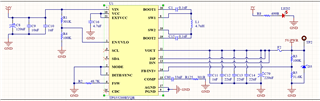

TPS55289: Schematic Review Required
Part Number: TPS55289
Schematic Review required for TPS55289RYQR. The input voltage range is from 5V-28V and output voltage is 5V 4A. I dont want to use I2C interface for output voltage selection. Does the following circuit provide the required output parameters without any I2C communication.
