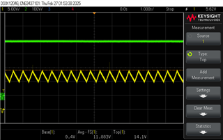

The problem I have is the circuit does not start normal operation, and when I checked VCCP it was triangular waveform, and according to the datasheet VCCP should be more than 14V(VCCStartSelf) for the IC to start switching.

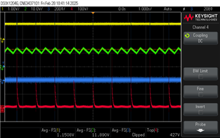

Also there are periodic pulses(about 1 second apart) on LO pin, which indicates some type of fault condition according to the datasheet.
Green trace is VIN 390V, yellow trace is VCCP
Green trace is VCCP, yellow trace is BLK pin, blue trace is LO pin

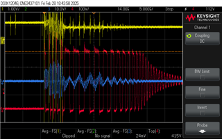

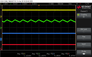

    the following is the TSET, V5P, ISNS and HS, waveforms before any modifications in the circuit:
    yellow = BLK, green = VCCP, blue = TSET, red = V5P
    yellow = BLK, green = VCCP, blue = ISNS, red = HS

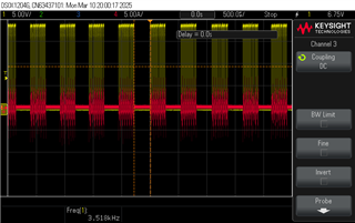

    yellow = ISNS, red = HS
    zoomed in

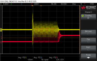

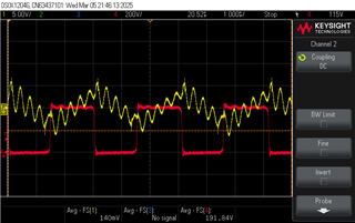

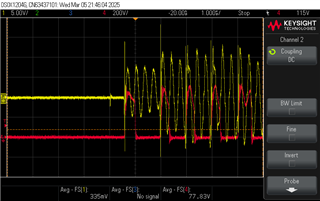

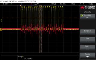

    after that I changed the sense resistor with 50Ohm one, and now the switching started but not continuous even at full load
    yellow = HS, red = primary current
    zoomed in
    and this is Vout
    yellow = HS, red = primary current, green = Vout (AC coupling)
    zoomed in
    I tested also with 100Ohm sense resistor and the circuit is switching with the same behavior as the 50Ohm one, and also tested with 220Ohm sense resistor but the circuit is not switching anymore, back to the original issue.
    I put the circuit in the original state (original components values) as before the modifications you suggested in the first reply, and it is still switching, actually the previous screenshots are taken with the original component values, so I think we can assume that the issue is the current sense circuit.
    in conclusion the circuit is switching now, but I don't know why the switching is interrupted, also by using low value for sense resistor I lose OCP, do you have an idea how to solve this?
    Controller is operating in the burst mode. You can tune the LL pin settings to make it work in the normal switching.
