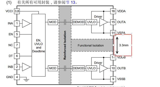

my customer want to know if the UCC21530-Q1 can be used in 800V OBC application? customer think Creepage distance need up to 4mm in 800V sytem, but our device is just 3mm.
