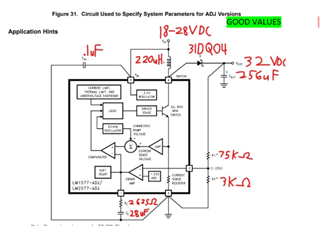

Hello! I have been working with this chip and with the design attached.
After having failures on a breadboard this circuit is now on a solder board for better connection.
It was working from 12/11/2024 until attempting to use it on 1/17/2025 when the circuit started smoking which caused damage to some capacitors, wires, and shorted the positive and ground rails of the board.
After checking and replacing all damaged parts and soldering the circuit together the chip now appears to be broken as the output voltage is now the same as the input voltage unlike the boosted behavior it did before.
This is the 3rd chip to fail even when the working circuit design is used.
Can someone help me understand where I could be going wrong and if there is possibly a better less fragile chip to achieve the results of the circuit shown above?

  • Niklas,
    This circuit only has a load of 0.5A.
    This circuit is meant to power some op amps with a load current of ~1A at 32VDC
    Looking at the datasheet this should be within the spec of the chip.
    Just to clarify the failure was not after a long time of constant usage. The chip was never in use for more than an hour at a time. It was also the first activation of the chip after many weeks that the failure occurred.
  • Hi Thomas,
    Thanks for the update and the clarification.
    I agree the operation conditions are within spec.
    The external components selected look okay to me as well.
    Right now I cannot say what the root cause is.
    Can you confirm there were no possible ESD hazards when storing and retrieving the boards?
    Can you also give more details and what is broken at the IC after the damage occurred? E.g. are some pin internally shorted, or is it just not turning on again?

  • Niklas,
    There were no ESD hazards present during failure.
    The electrical board was isolated from any possible other conductor or hazard during the test.
    After repairing the circuit (New parts, wires, new solder) the input voltage and the output voltage of the circuit remains the same.
  • Hi Thomas,
    Thanks for the feedback.
    So if VOUT equals VIN after turn-on, the device is simply not operating, but there is no short of the input voltage correct?
    Would it be possible to do waveform measurements at SW, FB and COMP pin voltage on the damaged IC?
    This might give additional insights why the IC is not working anymore.
    Can you also specify which components were broken aside from the IC?
    E.g. just the diode or also the capacitors?
