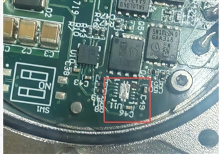

3、This is a burnt board

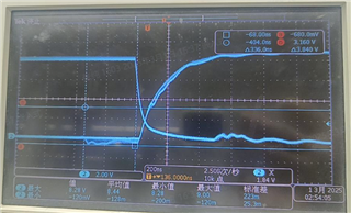

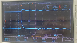

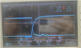

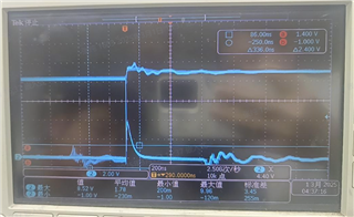

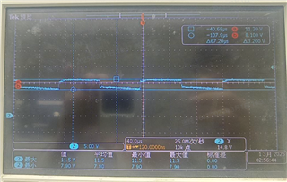

    3. The following is the waveform of the test point. Due to burning during normal use, the waveform is difficult to capture. The following waveform has a relatively slow response and the current loop is running
    The situation of 48V power supply
    Vgs (near MOS transistor), bridge up
    V (ho - hs) (near the gate driver chip)
    The situation of 60V power supply
    Voltage across the bootstrap capacitor
