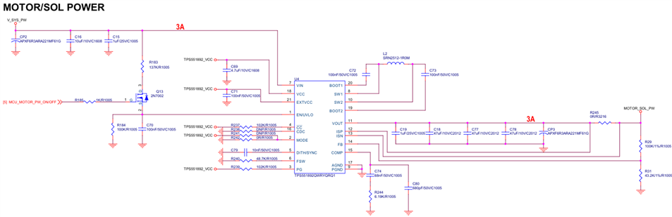

TPS551892-Q1: Request for TPS551892-Q1 schematic review
Part Number: TPS551892-Q1
Hi, TI expert
The customer requested a schematic review using TPS551892-Q1.
[spec]
- Input : 3.2Vdc ~ 4.15V
- Output : 3V , 3A
Are there any problems with the circuit? Are there any areas that need to be modified? Please review.
Thank you.
  • Hi Grady,
    Thank you for reaching out. May I know what is the application and customer here?
    Below is my feedback:
    1. If the MCU_MOTOR_PW_ON/OFF signal is higher than 1.23V, customer can directly use this signal to enable EN pin. Just add a 100kohm pull down resistor.
    2.Change C69 to 16V rated to ensure 2uF effective capacitance with DC derating.
    3.Change L2 to 4.7uH with 8A Isat.
    4.Recommend to reserve RC snubber in SW1 and SW2.
    5.If customer doesn't use the output current limit function, remove R245 and directly connect ISN and ISP to Vout.
    6.Can you provide part number of output caps for me to check loop parameters?
    7.Follow layout guideline.
    Mulin

  • Hi, Mulin
    I have modified the circuit based on the customer's comments.
    → Since the MCU output voltage is 3V, delete the existing circuit and connect the MCU directly.
    → C69: 4.7uF voltage change from 10V to 16V
    → 4.7uH/rated 5.9A/Isat 8.2A, SRP5030CA-4R7M change
    → Add RC snubber circuit
    → Short after deleting R245
    Please review the modified circuit attached.
    2705.Schematics.pdf
    Thank you.
  • Hi Grady,
    Recommend to change R247 and R248 to 1206/0805 package.

  • Hi, Mulin
    Our reply was delayed due to the customer's delay in responding.
    Mulin sadi) Can you provide part number of output caps for me to check loop parameters?
    → CP3: APXF6R3ARA221MF61G (6.3V / 220uF)
         C19,C18,C77,C78: It is said that the part number is not fixed. (Only the value on the circuit)
    Thank you.
  • Hi Grady,
    Thank you for your feedback. Recommended compensation parameters: R244=10k, C74=15nF, C80=100pF.
    Mulin
