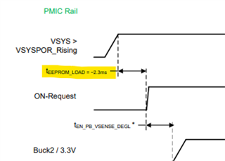

The TPS65219 datasheet, page 31, "Figure 7-2. Power-up sequencing (example)" shows the power-up sequence between the VSYS and the ON-Request, it is "tEEPROM_LOAD = ~2.3ms". It can be read by entering the ON-Request ~2.3ms after the EEPROM is loaded.

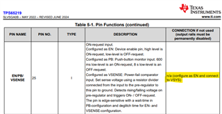

On the other hand, the (EN/PB/VSENSE pin) has three types of functions. And the On-Request appears to be valid only in PB mode.
If the application circuit is configured to pull-up the (EN/PB/VSENSE pin) at the VSYS potential, VSYS and (EN/PB/VSENSE terminals) start up at the same time.
They think there is no problem with this usage, but what is it?

    The pin description of EN/PB/VSENSE is ON-request input, which is an internal signal. It is normal to have a pull up on this pin to Vsys and both Vsys and EN will rise up together and internal signal will go high after EEPROM loading is complete.
    For a different version of the device when this pin is configured as PB, ON-request goes high when PB is pulled low for desired amount of time.
