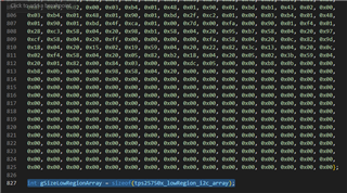

    At the end of the lowregion binary you can find the sizeof() function to report the size of the low region binary used for PBMx (PBMs).
