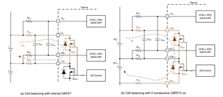

Is there way that I can use external passive balancing with BQ79652-Q1 ?
if so how to do it?

Madaka,
We already have internal passive cell balancing implemented on this device.
We do not have a specific design for how to create external cell balancing.
However, we do have our internal cell balancing architecture outlined in the datasheet.
You would have to recreate this externally and do your own validation to execute external passive cell balancing.
