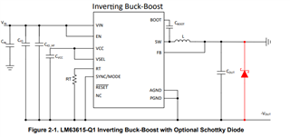

      We use LMR51606YDBVR per datasheet to build a +15V and a -15V output, now the board is in house, the +15V works ok,  but the -15V is failed to output? Would u like to take a look at our SCH as attached? Is anything wrong with the design? Thanks.

  • Hi Liz,
    A few things are different from the buck to an inverting buck-boost converter.
    Basically, input caps will need to be reconnected to a new system ground, and a cap, CIO (represented by C209) needs to be connected from input to output to account for transients.
    The enable will also need to be level shifted (or connected to VIN).
    Please see the attached app note:
    https://www.ti.com/lit/an/snvaa65/snvaa65.pdf?ts=1740766905941&ref_url=https%253A%252F%252Fwww.google.com%252F
    Richard

  • Hi Liz,
    It looks like something is pulling up the output. I see that you have a TVS D28, is it possible to replace it with a schottky rated higher than the absolute max of the 15V?
    Were these capacitors derated for the increased input? Derating may make the passives have lower values than intended.
    I would also suggest isolating the IBB from any other circuit to make sure there is nothing coupling in.
    Richard
