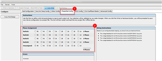

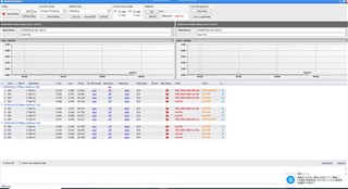

Hi
I made a board with the same power supply configuration as VC707.(Using UCD9248)
Wrote the same software as VC707, and passed all.
But, no output from UD9248
When viewed in the Fusion Digital Power D
esigned  tool, it is not operating.
What could be the reason it's not operating?
Thanks Regard.

  • Hello Hara-san,
    UCD9248 features fault monitoring functionality. It seems like the alert was issued due to "Low Vin". Make sure to check your supply rails to the UCD9248 and power stages.
    Kind regards,
    Nick Z
  • Hi Nick
    I changed the software to write it and it started working.
    It started working after I changed the software I was writing to. It works fine with the software released by xillinx.(XML)
    It doesn't work with a modified version of that software.(tisfp)

    >Modifying sequences in Fusion GUI can be done by altering the settings in Phase/Rail Config --> Phase Assignment
    I understand how to set it up. Thank you.
    thanks regard.
  • Hi Hara-san,
    Understood, thanks for your responses.
    No Vout regulation:
    First I would check PWM pins on the controller and try to capture if they are outputting a PWM signal or not. Checking the controller pins for PWM will help isolate where the issue is coming from.
    I would also recommend capturing IMON waveforms as well.
    Configuration:
    I will get to reviewing this within a couple business days. Thank you for sending over this configuration file.
    Kind regards,
    Nick Z
