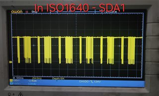

we are communicating BQ7695202 BQ IC with microcontroller STM32G0B1RET6 using ISO1640 I2C Isolator.
we are attaching following details:

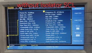

1. waveform without  ISO1640 I2C Isolator pull up resistor 1.5KR.

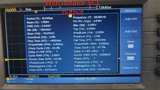

2. waveform with ISO1640 I2C Isolator pull up resistor 1.5KR bq7695202 side.
3. waveform with ISO1640 I2C Isolator pull up resistor 1.5KR Microcontroller side.
4. waveform with ISO1640 I2C Isolator pull up resistor 10KR bq7695202 side.
5. waveform with ISO1640 I2C Isolator pull up resistor 10KR Microcontroller side.
6. we are operate I2C at 100KHz.
as you can see data line in BQ7695202 side is shifted to 600mV from GND.
Please suggest solution for getting proper waveform

  • Hello Rahul,
    Do the SCL/SDA lines look okay when the isolator is removed? What do those waveforms look like?
    Can you also try adding the capacitors as shown in Figure 9-6. Typical ISO1640 Circuit Hookup from the datasheet and seeing if that helps?

  • Hi Rahul,
    I've review the inputs shared by you and came to conclusion that the issue that you're facing is SDA1 and SCL1 being DC shifted by 0.6V.
    If the above conclusion is correct then, then let me tell you that this is an expected behavior on Side1 of ISO1640 as VOL1(max) is 0.71V mentioned in datasheet.
    If you want to know more on why is that the case for Side1 of ISO1640 and how the architecture is made inside the device, then please refer to the following FAQ: https://e2e.ti.com/support/isolation-group/isolation/f/isolation-forum/757564/faq-why-is-the-logic-low-level-output-voltage-vol1-up-to-0-8v-on-side1-of-the-iso1540-iso1541-and-iso1640-iso1641-bidirectional-i2c-isolators

  • Hi Rahul,
    As Varun stated earlier, the voltage shift is expected due to architecture used in ISO1640 to achieve bidirectional functionality. This is a common approach used in the industry to implement I2C in isolator and is not unique to ISO1640 alone.
    I quickly reviewed the I/O thresholds of SDA/SCL lines in BQ76952 and I see that their VIL (max) is 0.53V assuming worst-case VREG18 of 1.6V. Since VOL(max) of Side1 of ISO1640 is 0.71V, I would say these two ports are not compatible.
    Please do verify if your MCU has a VIL(max) of >0.71V and if yes, then connect Side1 of ISO1640 to MCU and Side2 to BQ76952 and everything should work fine.
    If the MCU is also not compatible to ISO1640 Side1, then you can consider using an I2C buffers like TCA9517A where the VOL will improve to 0.6V. This buffer can be connected between ISO1640 and MCU where ISO1640 Side1 connects to SideA of TCA9517A and SideB of TCA9517A is connected to MCU. This is assuming that the MCU has a VIL(max) that is >0.6V (which is required by SideB of TCA9517A).
    Please consider these inputs and let us know if these inputs resolve your issues, thanks.
    Koteshwar Rao
