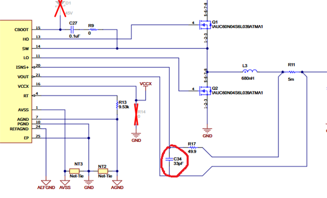

  • "VOUT coupling capacitor"
    Where should this capacitor you mentioned be placed?
  • Hi Luke,
    This how the capacitor is used on the EVM:
    Andrew
  • This capacitor definitely helps at some points...
    It is now stable at 0A, 3A, 5A, and 7A and above, but at 1-2A, 4A, and 6A loads the voltage randomly drops to 8V-11V output from 13V....
    I don't see any rhyme or reason for this issue...
  • I went from a 56pF to a 1nF to a 10nF to a 100nF decoupling capacitor and get some varied results, but one thing seems to be constant, that at 12A, whether it is stable or not, the output voltage drops down to 10.5-11V... I do not understand this... The 1nF capacitor seems to be the most stable, but it still does this...

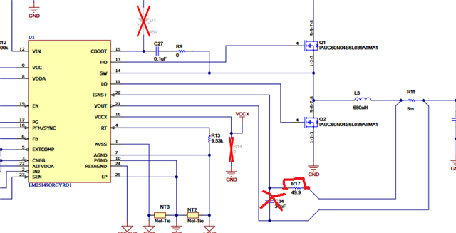

  • Hi Luke,
    What effect does doing the opposite do?
    What happens if you remove the coupling capacitor and the short out the ISNS resistor. Could be not setting the current limit correctly. Can you share the inductor current, if possibe?
    Andrew
  • I did this, and the audible noise is back, and also with 1A load, the output voltage is at 8V, with 2-12A load the output varies between 13V and 6V and it really jumps around... The 1nF capacitor is the perfect solution, besides we still need to get rid of the part where it jumps down to 10.5V... The duty cycle just jumps down like 10% and there is a hysteresis between the current draw when it jumps down and when it jumps back up... Is there any type of monitoring inside the chip that would cause this?

  • I have now adjusted this capacitor up to 5.6nF without making the circuit unstable and am now able to keep output voltages of 12.6V all the way up to 14A, but it still drops down to 11V output at 15A... I do notice that the spikes across the current sense resistors seem to double in frequency one the output voltage drops, does this mean it is the current limit?
  • Hi Luke,
    Yes, if there's a spike across the current sense resistor then the device will current limited. That's why the device is lowering the output voltage. My recommendation would be to try a larger Sense resistor and see if that fixes the problem.
    Andrew
  • I had already tried this on day 1... I added another 5mOhm, so 3 in parallel, and it still has this voltage drop at the same load current...
  • I added the capacitor you mentioned and changed to a different switching MOSFET to eliminate this issue, which makes no sense to me but it works... Still I think there should be some indication that there is a difference in the automotive and the regular LM25149...
