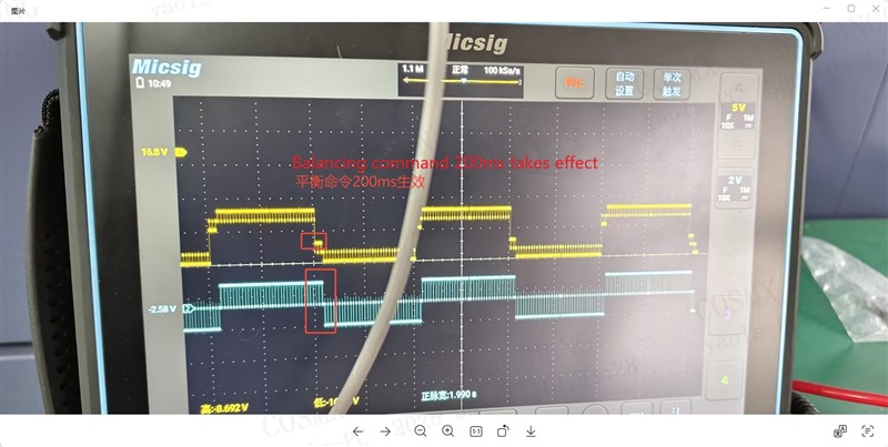

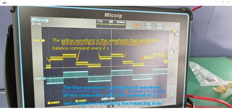

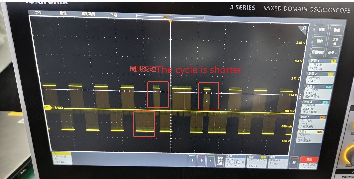

    I think the issued isn't caused by COV and CUV. Because in below balance waveform, the abnormal balance time are 0.5s and 3.5s while the normal balance time is 2s (2s is configured by software). It means sometimes the balance time is 0.5s and sometimes is 3.5s (it happens once or twice in 1 to 3 minutes). And the balance command which sent by MCU and cell's balance statue which read by MCU (0x0083 command) all are 2s when the actual balance time is 0.5s or 3.5s. Please help to confirm this issue.

  • Hello Ryker,
    Just to clarify, the waveform showing just 1 AFE switching between an odd/even cell for ~2s each, but is this just happening for the top AFE or bottom AFE or both? I see from the configuration file that it was mentioned that there is a ‘Low-side AFE enable balance’ and ‘High-side AFE enable balance’. Also, how many cells are being balanced at once?

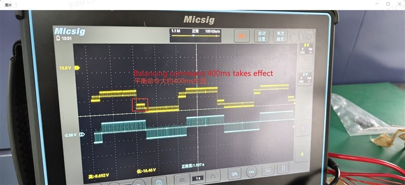

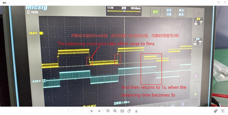

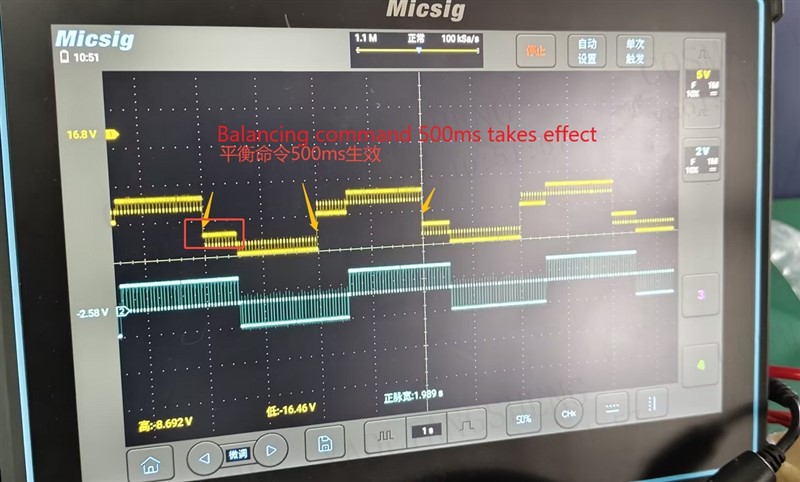

    • Customer suspect the issue is caused by Subcommands of 0x0083 CB_ACTIVE_CELLS(). According to the BQ76952 manual, when writing the balance command 0x0083, it takes about 1 second to take effect. However, in reality, this 1-second interval fluctuates and gradually decreases. When it decreases to almost 0, it resets back to 1 second. This switching process causes the balance cycle to be inaccurate, resulting in an additional 1-second delay. Please refer to below waveforms for the details. And help to confirm the reason and how to avoid this issue.
    This is possible as the command does not always take 1 second to take effect. Unfortunately, there isn't a known way to necessarily avoid this as we cannot control the timing of the subcommand.
