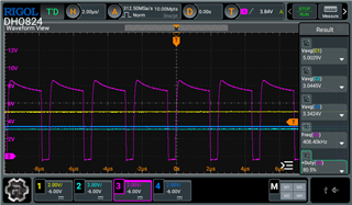

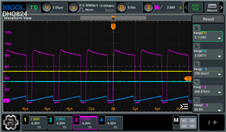

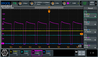

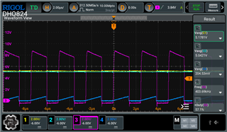

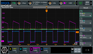

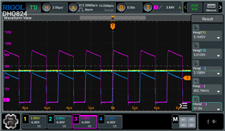

I am working on a prototype for a wide input voltage to 5v @ 1A power supply.
I am finding that my prototype fails to regulate when VIn passes below VOut.
Specifications:
In: +4v to +48v
Out: +5v @ 1A
Freq: 407 kHz, Soft Start 2.5ms
WEBENCH Link

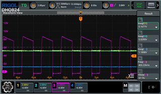

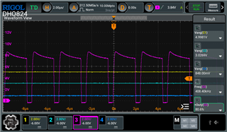

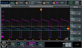

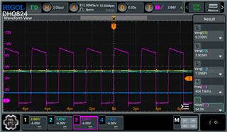

Schematic:
Scope Captures:
CH1:
VIn
CH2:
VOut measured at 30 Ohm load
CH3:
HO
CH4 Boost Mode (roughly 100-200mV above the mode change threshold) Buck-Boost Mode (Regulation Failure)
COMP
HS
LO
FB
RAMP
SS
Please let me know if you need any further information or scope captures.
