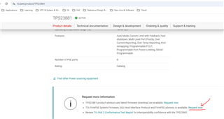

Hello TI Support,
I am trying to run the TPS23882B1EVM008 with an MSP430FR5969 kit in Semi-Auto mode. I downloaded the SLVC790 demo code but consistently encounter an "SRAM Code Load Error!".
To troubleshoot, I replaced the SRAM and Parity code with the latest 0x15 version available for the TPS23882 and added the missing register writes (for RAM preparation) from SLVAE12. However, at the end of the process, I always read 0x00 for the SRAM version.
Could you confirm whether SRAM firmware is required for the TPS23882B, or if it is not needed for this version?
