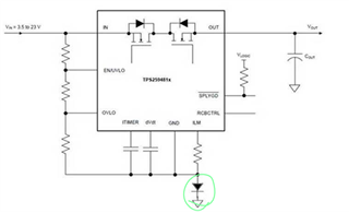

    Both device do not have always on so EN pin can be pulled up to other pull up power rail (if the end application have one)
    In case of TPS25948, you get wscp package, typical ron is less than 20mOhms but reverse voltage protection is absent which can be implemented using a diode.
    In  case of TPS25947, package is QFN-10 so little higher package. The typical ron is slightly higher (28mOhms) but will provide reverse voltage protection so no need to add diode at ground.
    Both devices will provide RCB, Ilim = 4A, OVP, inrush current control i.e. output voltage slew rate control during eFuse startup.
    Adj UVP won't be present due to pulling EN to logic high but fixed UVP will still be present for both devices.
    TPS25947 might be a better solution here due to size constraints (extra diode not required for Reverse polarity protection). If RPP is not required, then TPS25948 will be better solution.

    What is expected to be on Vin pin if VBUS > 5V is applied to Vout pin?
    5. I see that TPS25948 does not support Vin Reverse polarity protection and TPS25947 is Yes?
    Does it mean that if Vin reverse polarity -XXV is applied, the 948 will be damaged?

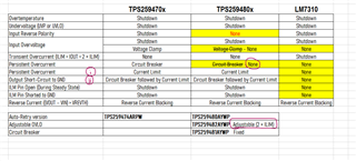

    7. I am summarizing the Fault conditions supported by eFuse and Ideal Diode.
    The real difference is a Reverse polarity protection. Do I miss something?
    Vitaliy
    Yes. If negative voltage is applied, in case of TPS25948, gnd to pin current may flow through the esd diodes and may damage to device.
    Overall you have covered most of the things. I will just add some comments on this.
    1) After current limiting, the device will go into thermal shutdown depending on the power dissipation on the device.
    2) here also, after current limiting, depending on the Vin, you may see device going into thermal shutdown very quickly.
    Adjustable OVLO is different from 2*ILIM. We call this scalable current limiting as scalable fast trip (SFT). This is also present in TPS25947 device. This mechanism provide protection against the short circuit.
    Please let me know if there are any follow up questions.

    1. It seems like I will go to use one of the following versions:
    TPS259474ARPW (Most of Shutdown protections) + Adj OVLO / Breaker / Auto-Retry
    TPS259480AYWP (Most of Shutdown protections, No RPP, No OV Voltage clamp)+Adj(2×ILIM)/Auto-Retry
