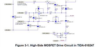

    1. Thanks, we've read some your reference designs and application notes. So, we've decided to apply high side protection. I got tons of question about your discrete circuit on DSG, and CHG. I read a  Design Considerations of Stacked BQ769x2 With High-Side N-MOSFET. Whereas, I still confuse how they logic works. Could you explain more about that? Such as:
      1. that reference design has a separate ground, what's voltage on TOP_REG1 and BOT REG1?
      2. I got confusing to see that circuit lol, could you explain it clearly?
      3. On the "BQ769x2 Frequently Asked Questions" document, it said "high side applications, the CHG and DSG pins voltages are the voltage of the attached battery pack plus the voltage provided by the charge pump." I'm going to separate half the battery pack so 32V each stackup. So, do each AFE CHG and DSG produce around 41V? (I'm going to configure at Settings:FET:Chg Pump Control[LVEN] 11V)

    2. Hello Fairuz,
      REG1 voltage should be 3.3V for both the TOP_REG1 and the BOT REG1. This can be found in Section 2.1 Data Communications of the Design Considerations of Stacked application note.
      Which part of the circuit are you asking for more clarity on?
      Section 3.1 Discharge MOSFET Turn ON and Off Processes and the following sections, go over the circuit more in detail to help explain the design.
      If you configure the charge pump to be 11V, then you can expect the CHG and DSG pins to be around the voltage of the attached battery pack + 11V.
