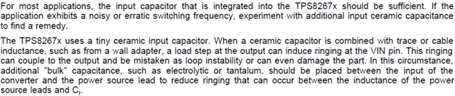

Hi team,
May I know if we need to add extra input ceramic or bulk capacitors in the usecase below? I cannot judge if they are needed or not in customer's situation..
Input voltage: 3.3V
Output voltage: 1.5V
Output current: 0.153A
Shunsuke Yamamoto
  • Hi Yamamoto-san,
    For the typical optical module application, where everything is squished together on a tiny PCB, no other Cin is required.  There is plenty of additional capacitance present on the input bus, from other regulators, etc.
    Chris
