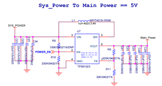

The schematic diagram is as follows:

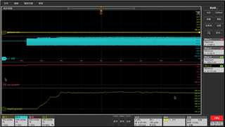

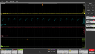

sys_power is 2.8~4.2V,main_power=5V.when power_en=0V,Why does the main power have a 1V output?
Supplementary information:channel 1: power_en,channel 2:U7 SW,channel 3:sys power,channel 4: main_power.
Figure 3 is a magnification of Figure 2.

Hi Albert,
Normally the output should be zero when EN is 0.
Is the waveform measured on EVM or your board?
If available, please try a new fresh unit and measured whether the waveforms are the same.
Lei
Hi Lei,
The reason has been found. The switch of other chips has affected the SW pin of TPS61032.
Thank you very much for your reply.
