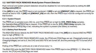

I have a circuit which is powered by a battery and charged with a charger plugged to the wall. If I am working with battery power and the battery runs out, I want to be able to remove that battery and use a charged one. And at the moment if I do this the device doesn't power on until I plug the charger. After I disconnect the charger, the battery works fine. In chapter 5.2 from the "sluub63a" I read this: "NORMAL Mode: ....The [NR] bit is set, and the system asumes a non-removal battery pack"
I looked for the NR bit in this document and in the bqstudio with the EV2400 connected to my device, and I couldn't find it.
In the "sluub63a" document it says it is a bit from the DA Configuration, and there is no reference to that bit anywhere.
