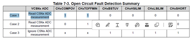

We tested the open circuit test of TPS92520 and found that sometimes the open circuit fault cannot be reported.
We have already done it according to this detection logic, and there is still a certain probability that the fault cannot be reported, the waveform of the output voltage of our test 92520 is as follows, and the waveform is close to the STATUS 3.
However, in the test, it is found that the condition of point B cannot be established, and the condition of point A may not be established.
Please help us to see how we should improve our logic of detecting open circuit, or which part is wrong, thank you

  • For No. 1, 4, 6, 9, Open circuit is also detected. Please refer to below case 1.
  •  This is the case where we tested the open circuit. This picture is the register state diagram, but CASE1/2/3 did not appear at the same time.
  • You don't need case 1/2/3 appearing at the same time. Either one meets the table, open status is detected.
  • Yes, I understand what you said. If we perform open circuit detection according to the above flowchart, there will be a probability that CASE1, CASE2 or CASE3 will not be satisfied, I attach this picture to illustrate the scene that does not meet any CASE when there is an open circuit.
    I would like to add the detection strategy on our software, only after meeting the above flow chart conditions for 10 times in a row will the open circuit be reported. If there is a normal time during the period, it will not be reported. Therefore, if we have an open circuit, we will report a fault for a while, no fault will be reported later.

  • What is the result when you first read register data after open condition? What is the delay time for each reading? Can you read with longer delay time?
    some registers fault might be cleared if you repeatedly read status registers as "Reading the register clears the bits that are set if the condition that caused them no long exists."  You may read result with waiting for long enough time.
