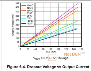

I want to check with you about the min requirement for LDO input voltage when loading between 100-132mA.
In datasheet , only DRV package drop voltage VS current wave (Figure 6-4. Dropout Voltage vs Output Current  is typ value wave?), no DGN package wave.
Figure 6-4. Dropout Voltage vs Output Current  is typ value wave ?
Below  is  DGN or DRV package wave ?
