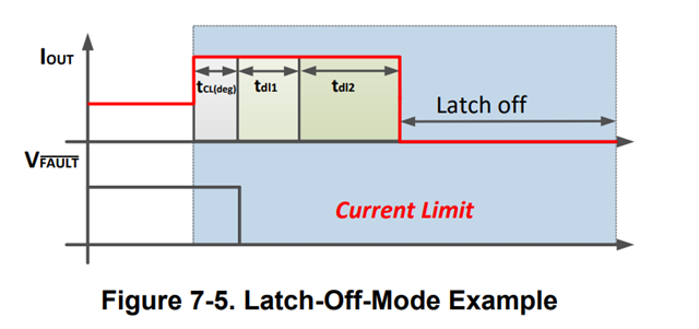

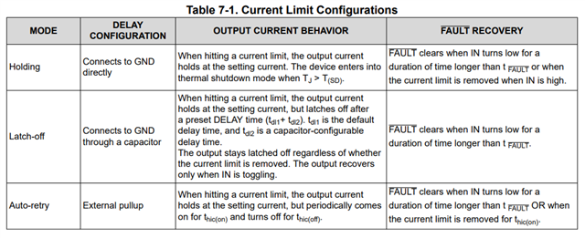

Hi Luke,
No, it cannot be zero. The device only supports the following configurations which correlate to the three different outcomes when the current limit is reached. For the latch-off mode, a capacitor must be used, so tdl2 can be minimal but cannot be zero.
