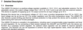

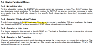

I'm going to use LMS8117A to make a system that regulates to 3.3V by receiving 3.6V. But The difference between the input and output voltages is not large, so it is difficult to be sure that they can be used.
Please check if it can be used for my design, and if it is difficult to use, please recommend LDO (small package, cheap price) that can output up to 1A.

    Thanks for reaching out. I assume 3.6V input is the steady-state Vin here -- What is the maximum input voltage rating the LDO is required to have?
    Also, to help address your question about dropout, can you share the ambient temperature range of your system? LDO dropout generally increases with increasing load and increasing temperature, so I'd like to account for this when looking for a device in our portfolio with <300mV dropout at 1A load.
