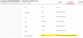

I looked at the datasheet and calculated the heat output.
The thermal resistance values ​​shown on the datasheet are as follows:
According to this, the thermal resistance should be calculated at 110℃/W.
However, Power Designer estimates it at 60°C/W.
I understand that 60°C/W is an EVM (evaluation board), but I would like to know which thermal resistance should be used when making estimates.
